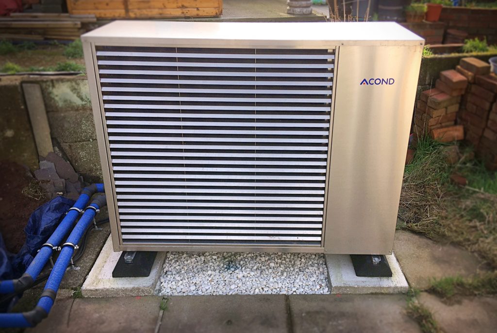

I became involved after the PRO-R unit was installed and operational, heating the home and its domestic hot water continuously. The homeowner expressed concerns over the resulting high energy bills, which ranged from £10-15 daily. A lack of handover instructions and the impression from installers that the heat pump could not be deactivated exacerbated her worries. Her attempts to communicate with the company were largely ignored, leading to significant frustration and highlighting a lack of customer focus on the company’s part.
Upon inspecting the installation, I identified insulation deficiencies both inside the house, where it was missing, and outside, where it was substandard in certain areas. Additionally, I was troubled by the significant increase in heat pump capacity, jumping from a nominal 6kW to 16kW. This led to the placement of the larger model at the far end of the garden, necessitating a lengthy pipe run back to the house.

Following considerable debate and the client’s decision to withhold the final payment, the company finally provided the instructions. Once connected to the heat pump’s control software via a local network, we discovered that the system was set to heat domestic hot water to over 62C daily, despite the client not having any operational hot water taps and requesting this function be disabled.
Attempts to modify the heating and hot water schedules were unsuccessful; the heat pump would activate at the set times, yet no temperature increase was detected at the radiators. After additional discussions with Thermal Earth, they consented to dispatch another engineer to address the problems.
The new engineer quickly identified and resolved the issues within an hour of his arrival. The control software had both heating pumps deactivated, blocking heat delivery to the radiators and underfloor heating. Furthermore, the immersion heater for the hot water tank had been left on, causing continuous heating of the water to the thermostat’s set temperature, likely since the initial handover more than a month prior.
Fortunately, the owner now has a fully operational heat pump system. Despite receiving written assurances from the company that the heat pump is appropriately sized and will not cycle excessively, they have firmly declined any offer to replace it with a smaller model if it fails to meet performance expectations. I plan to update this review in the future with further evaluation of the system’s performance.
