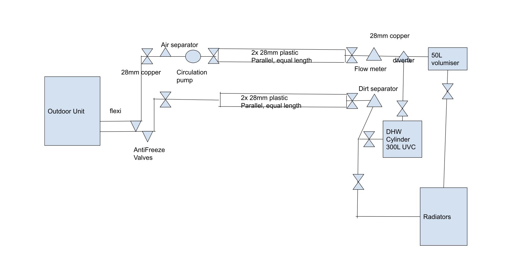

During the summer of 2022 I replaced six radiators and ran a new primary pipework to the ASHP location. The ASHP is actually directly outside where the boiler is, but I wanted new primaries as the boiler ones were way undersized for heat pump. The new primaries entailed floor lifting and joist drilling in my son’s room, so we bribed him with a new set of furniture once it was put back together.
The primary pipework bears some expanding on. Having spent time working out all those numbers, it becomes apparent that for 16kW at DT5, 28mm copper is OK-ish, but the numbers look a lot better with 35mm. But 35mm is expensive, the fittings are not available in the usual suspect stores, you have to go very specialist (whereas 28mm is ubiquitous) and is only press-fit requiring expensive tools or solder. Basically it’s for the pros. I did talk to a pro about him doing it, but it would have had to go a much longer way round through the main loft and been very expensive. So I opted for a hybrid approach, which comes out in my system schematic:
The pipework for the first few metres from the ASHP is 28mm copper (external part insulated using PrimaryPro). I’ve fitted antifreeze valves as I am not using glycol. This goes inside into a loft over the utility room (single story) where I’ve fitted the circulating pump and air separator. It then branches into two parallel 28mm plastic pipes for the long-haul (approx. 8m) to the airing cupboard.
This meant running 4x28mm plastic through the floor of my son’s room. Being plastic, I could do sweeping bends, no joints were needed and it was all a single run. It’s also considerably cheaper than copper and gave me a guaranteed leak-free route under my son’s floor (bearing in mind that the pipe was fitted six months before it had any water in).
It then goes back into 28mm copper for the section in the airing cupboard, where the volumiser, diverter and UVC sit, and the distribution to the radiators comes from.
There are isolation valve points everywhere, very useful when testing methodically, step-by-step.
A word on the air separator. We had horrendous air problems with our boiler-driven central heating system back when the boiler was moved to the utility – a long flat primary pipe run. These only went away when the boiler fitter added a Spirovent AAV to the flat section just upstream of the boiler. I knew that I was doing the same again, so had to have the same solution. I was also keen to have a proper magnetic dirt separator in the system rather than a basic strainer filter.
There is a lot of commentary out there that says you should not have components like magnetic dirt separators and AAV’s in ASHP systems because they slow the flow rate. In my opinion, this is something of an over-generalisation. But if you use standard 28mm units from a plumbers’ merchant intended for boiler use, they will indeed do that, as they have a high internal pressure loss at the flow rates needed for an ASHP. I suspect this is where the simplistic view comes from.
If you take the time to research pressure loss curves of components and go up a size, then there are several that have acceptably low losses at ASHP flow rates. I selected the Spirovent AAV in 1 ¼” BSP sizing, and the Spirotrap MB3 dirt separator again in 1 ¼” BSP. Note that while these are both available (and cheaper) in 28mm, I felt that the lower pressure loss of the larger size was necessary. 1 ¼” BSP to 28mm adapters were then needed. I thread glued them in with Loctite 577.
The diverter setup is also a component to be chosen carefully. A typical 28mm 2-way or 3-way central heating zone valve has again very high pressure loss at ASHP flow rates. I was amazed when I took the ones off my system (that were for the boiler) and saw just how thin the inner bore is. After feedback on the Renewable Heating Hub forums from Brendon Uys (Heacol) to look at Bellimo or ESBE, and again a lot of time on manufacturer websites, I selected the ESBE VRG131 valve – again in 1 ¼”  for lower loss. This also needs an ESBE ARA actuator (aka zone valve head) as they are separate components. These together do cost a lot more than a typical central heating zone valve.
It’s worth saying that these key components – AAV, Mag separator, Diverter – were key factors in the overall pressure loss calculations. They were also significantly more expensive and harder to find than the typical 28mm alternatives.
I decided on my final design in January 2023 after reading a lot more from Brendon Uys, Marko Cosic and Graham Hendra, to go with a single loop (no buffer) to avoid buffer distortion loss, but recognising that that made me responsible for getting the flow rate and volume design and engineering right.
I went for a Samsung G6 as my ASHP as they are mass market units, tried and tested, well-priced, available from several places, good MFR documentation, there are good third party training videos for installers  (thanks Graham Hendra) and the manufacturer’s training is free (I went on it).
The separate pump means if you need a bigger pump, you can fit one – in my view that’s a good thing. The final decider was the availability of a modbus interface to allow me to monitor it directly (from Home Assistant, along with all my other stuff). The hope being that eventually I can also optimise its performance by sending control signals such as increase/decrease output or temperature using modbus rather than relying on MFR controls which will inevitably be limited in one way or another. The downside is that although natively it does weather compensation it doesn’t do load compensation much (if at all). There are third party companies (Homely) doing this as an add-on, via modbus, so I knew it would be possible.
Physically fitting the volumiser, diverters, etc. was interesting as there isn’t a lot of space in the airing cupboard – I spent hours searching MFR specs for different shapes and sizes buffer tanks that I could use as a volumiser. None of the pros I spoke to previously were prepared to fit in there. They all said “all the stuff will have to go in the loft” which would have been simpler and quicker for them, but I really wanted to stay inside the heated envelope for long-term efficiency. So I spent a lot of time trying different pipework arrangements until I found one that I could make fit. A benefit of being a DIY’er – a pro would have just said, “It won’t work I need to put it somewhere else.”

Building the ASHP with new primaries allowed me to wet test all the way from the ASHP to the volumiser during February, without affecting anything in the house that was keeping people warm, and temporary bypass loops allowed me to commission the ASHP fully.
I finally got enough of a window to cut the system over on March 25, 2023.  My target was by end of March, so I’m really pleased to have hit it.
Partial drain down, move the radiator connections in the airing cupboard to link into the ASHP primary side, refill and test. No heating for only about two hours. I switched the boiler off on its electrical isolator and off at the gas meter – that was very satisfying.
I’m thrilled to say it’s all working nicely and we’re running on the ASHP. After one day, with outside temps at 6C, the house is staying at 20C with an LWT of 38, so I’m very happy with that too.
