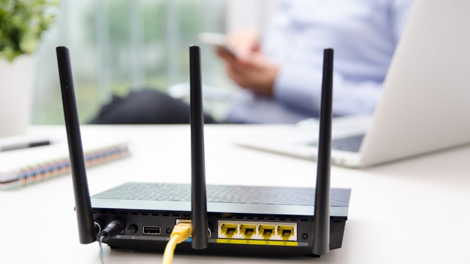

The starting point
So let’s take a look at how things are set up in most homes. At some point you had a chat with a service provider and they installed a connection. The engineer who visited likely installed their little box on the wall at a point convenient to them, and they left you with a router that would let you use your swanky new broadband.
That router now represents your home network in its entirety. If you want wifi, that box provides it. If you want to plug in something with a network cable, that box has a few ports that allow that. You obviously don’t want the world looking back down that connection at everything on your network, so the router also has an inbuilt firewall. Not bad for a freebie.
However, if you look a bit closer you start to see the limitations. The “convenient” point the engineer put the router was near the front door, meaning wifi is rubbish at the back of the house (or other installation point vs furthest point away from it). If someone’s watching a movie, everyone else’s wifi slows down. If you want to plug more than four network cables in, that router isn’t the tool for the job. And the ISP promised a router; they didn’t promise a GOOD router.

If you look at your router, it will have some network ports. In technical parlance, they are RJ45 sockets (which describes their shape) and if you want to plug a computer in then you can plug one end of a network cable into the computer’s network port and one into a port on the router. At that point you’ve got a really good connection. It’s a wire so it’s reliable, it’s fast and no-one can listen in on the conversation. The only downside is that there’s a wire trailing across the floor.
Most home routers have four of these network ports, so it’s not long before you’ve reached capacity. The way to deal with this is to use a network switch; a separate box with considerably more network ports that you attach to your router using a network cable. You can then plug your computer into the switch which then passes the conversation to the router. Switches typically come with 8, 12, 16 or 24 ports and are still just as fast, just as reliable, just as secure. What’s more, if you need to you can get more switches and plug them either into the router or into the first switch sort of like a daisy chain. Trouble is there are lots more wires trailing across the floor.
