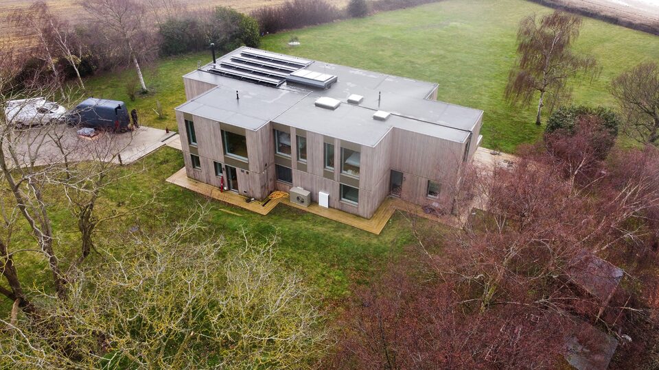

Plan which heating technologies you want early in a building project. Very often we see clients who have left this too late and find that they have not allowed enough room. For a single outdoor air source unit you are typically going to need a few metres square for the unit and space around it for unobstructed airflow, whilst a domestic indoor ground source unit is similar to a fridge freezer in size.
If this is a new build project then it is vital to ensure that your architect and builder are briefed to consider the space requirements for renewable technologies at the beginning of the project. To this end, it is worth spending some time familiarising yourself with the impact and requirements of different heating technologies as early as possible in your project. These requirements might influence your overall design.
Installing a ground source heat pump may mean digging up land to install a ground loop collector (you could attain approximately 25W per square metre and up to 35W per linear metre of borehole, so you need to calculate if you have enough suitable land for your needs).
Air source heat pumps, have a relatively small outdoor footprint and are easy to install; but tend to produce slightly more noise than ground source machines. Depending on the refrigerant used there may also be restrictions on how close to doors and windows they can be positioned. Both need to be a considered when thinking about the positioning of the outdoor unit.
Don’t forget that you will also need indoor space for controllers and water tanks for both types of heat pump – a particular consideration if you are moving away from a combi-boiler that didn’t require them. How much space is required of course depends on the size of your property and how much hot water you need and whether you will be installing underfloor heating and require space for actuators.
