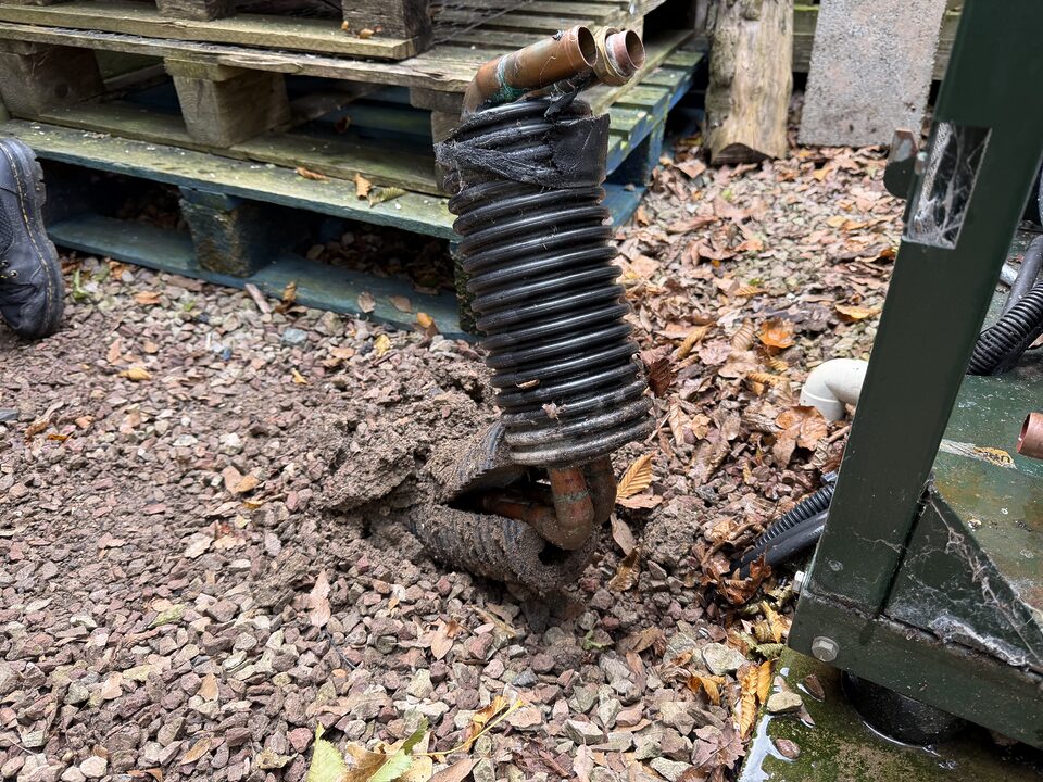

The root cause is straightforward. External pipework connecting heat pumps to homes is routinely being insulated with materials designed for indoor use.
When that insulation becomes saturated (as it inevitably does outdoors) the water travelling through those pipes loses heat before it ever reaches the house. The heat pump then works harder to compensate, drawing more energy and pushing up bills.
“We first became aware of the issue when households complained their heat pump had stopped working as well as when it was first installed,” said Lisa Malyon, co-founder and CEO of WattsWatt. “It turns out their external pipework had been insulated with basic grey insulation designed for inside, and it was soaked through.”
