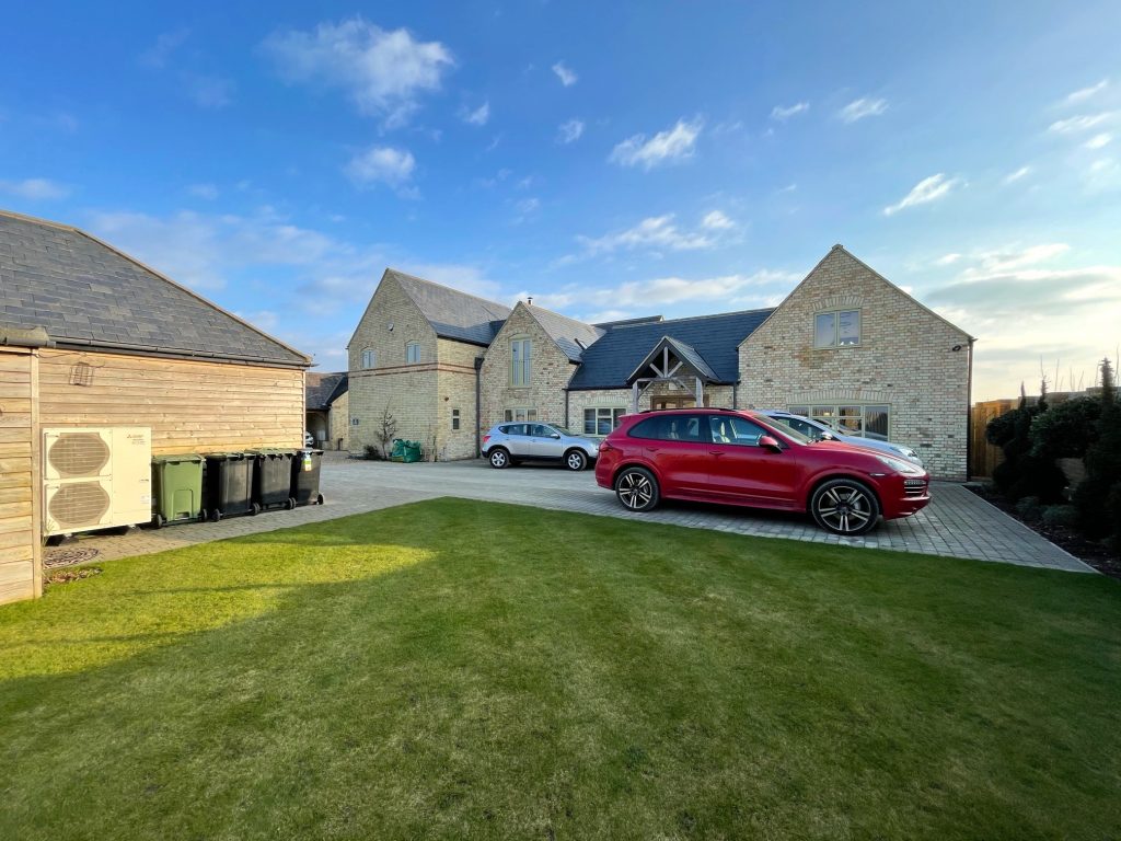

George, I assume your house is the stone building in the background? If so how far how far is your ASHP from the house and where is your cylinder?
Your numbers are quite encouraging. We’re getting the same ASHP as you in a much smalller and quite well insulated house. There are only two of us and we’d find 22 deg too warm.

Looking at the photo of the pump I wonder if having the bins so close to the pump is restricting air flow and possibly affecting the pumps performance? As the fans blow air out I’m assuming it has to suck it in from the sides and back.
