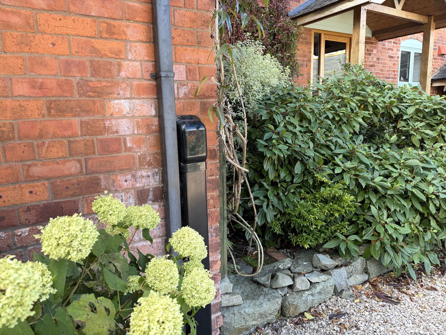

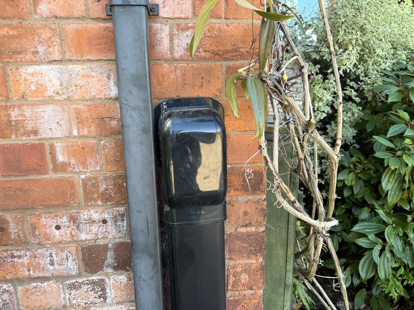

Game time!
Here’s the trunking that hides our wiring, heat pump flow & return pipes. What do you reckon is waiting under the cover?
  • Professionally lagged to perfection?
  • A few rough edges but nothing major?
  • Full-blown shocker?
Place your bets before I lift the lid… 👀

bontwoody
@Mars I’ll go with shocker 😁
@Mars In light of the previous postings on the matter, I think Shocking is the nearest but may lack true strength to describe the magnitude of the real situation! Toodles.
Tim441
@Mars I’ll try and keep a little faith…

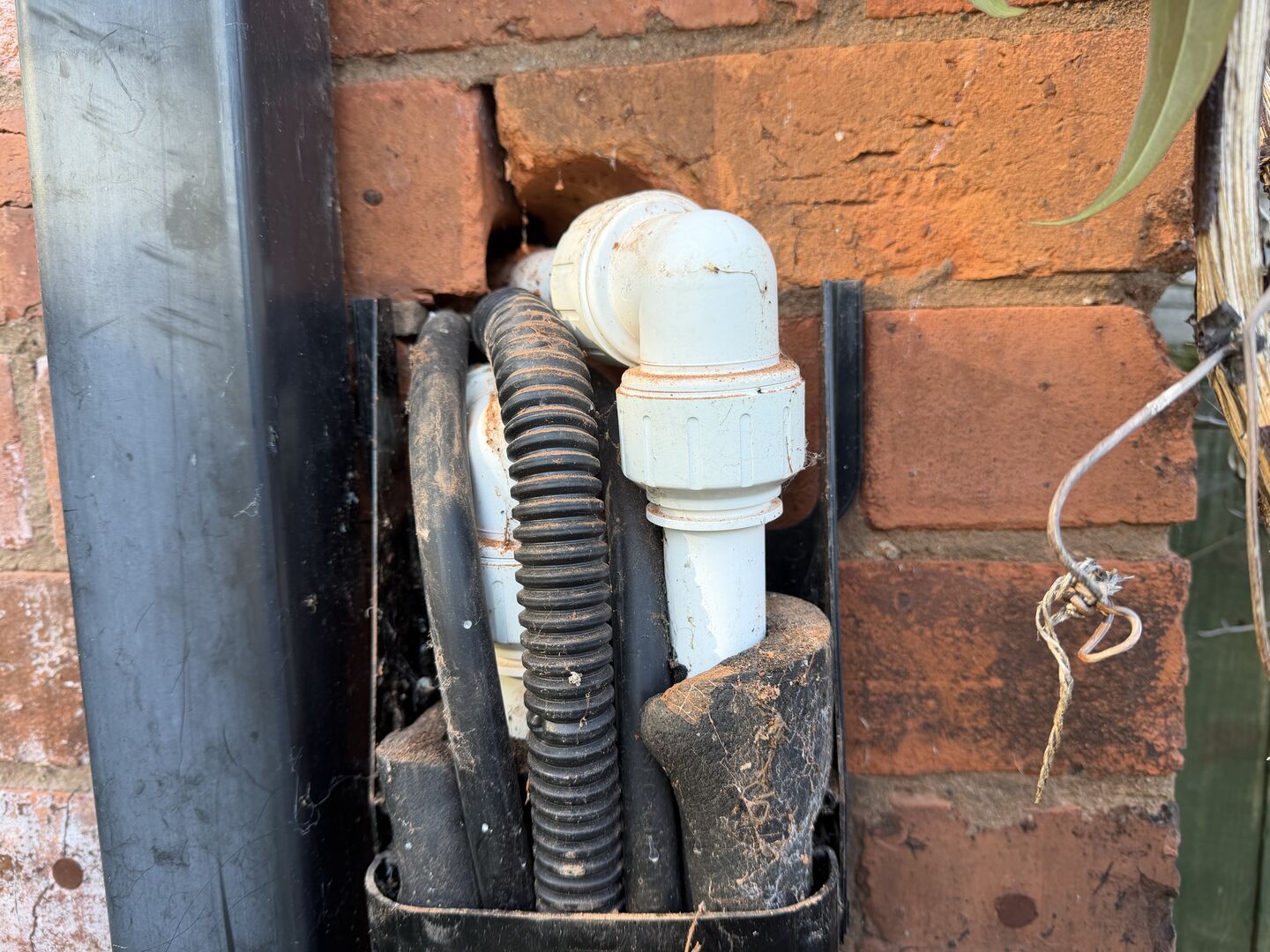

Interesting. I’ll let you all decide.
Insulation inside trunking
Tim441
@Mars yep… pipe size is more of concern maybe?
Insulation can certainly be improved!

Not sure what we are looking at, other than evidence of an installer who says ‘here is a hole, let’s shove everything inio it’

Yuck, yuck and more!
Others have pointed out lots already and yet your installer claimed that he did a great job!
In order of horror level
@Majordennisbloodnok ‘ s spot of totally inadequate pipe size! Especially given the size of ashp!
then rodent ingress opportunity
then not vibration isolation nor insulation to the wall
then lack of insulation to air around the bend
A great example of putting lipstick on a pig/ whatever  phrase springs to mind. Just so untidy, slapdash and shows zero understanding of what matters, but just cover it up.

What size are those plastic pipes Mars?
@bontwoody, not big enough (an excellent spot) 😉
Old_Scientist
Indeed. If the primaries are not big enough to carry the heat into the property, heat loss due to poor insulation is the last of your worries as there may be insufficient heat flowing in the first place.
Are you going to replace with 28mm or 35mm copper, and properly insulate?

Also loads of water ingress… the foamy insulation is damp, which leads to more unnecessary (and completely avoidable) heat loss.
And mice or other pests given the gaps.
My first concern is that the hole through the brickwork doesn’t appear to be sleeved.
There should be an outer casing which takes the weight of the wall above.
That allows the inner pipes to move freely as they expand/contract with temperature.

We have a lot of work ahead to get this done properly. All valid points above.
