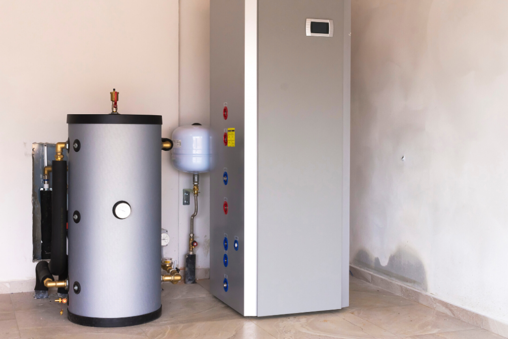

But wouldn’t a buffer tank allow running the heat pump water circuit pressurised, whilst allowing the existing gravity fed heating / hot water system to remain un-pressurised (thus reducing the risk of failed radiators on an old system – ours is 40 yrs old…)? I accept that the complexity is increased, but potential reliability should be increased, plus fault finding potentially simplified as ‘all’ the heat pump has to do is keep the ‘bucket of water’ at 55degC.
Graham
The buffer has nothing to do with pressurisation, most heat pumps can be either pressurised or open vented, the only unit I know of which needs to be pressurised is an Hitachi. Regarding the cylinder this can also be unpressurised or open vented, again it makes no difference. It’s your house you can have whatever you need or want.
If you have 40 year old heating it’s about time it has a refresh – trust me, it’s time to replace the rads. Would you keep a 40 year old car and hope it was reliable?
Buffers do not in anyway decrease or increase system reliability. A buffer is a throwback to the old days when we used them for short term heat storage. It’s no longer something that’s needed. Hope that helps.
And please don’t let your installer set your unit to run at 55C all the time. The efficiency will be horrible, let the unit weather compensate the radiators, it will save you a lot of money. Trust me, it will be ok.
