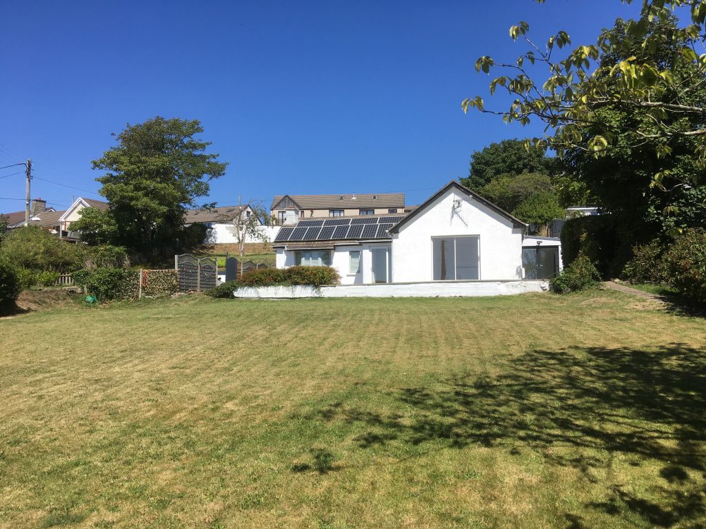

In August 2022, we moved into our new two-bedroom house in Pembrokeshire. The bungalow, originally built sometime in the 1800s, was of solid stone construction. It had been extended in the 1970s with a new kitchen and front room featuring double breeze block construction with loose-fill insulation. The EPC was an optimistic C, but it did have 2.66 kW of solar panels on the highest FIT tariff.
