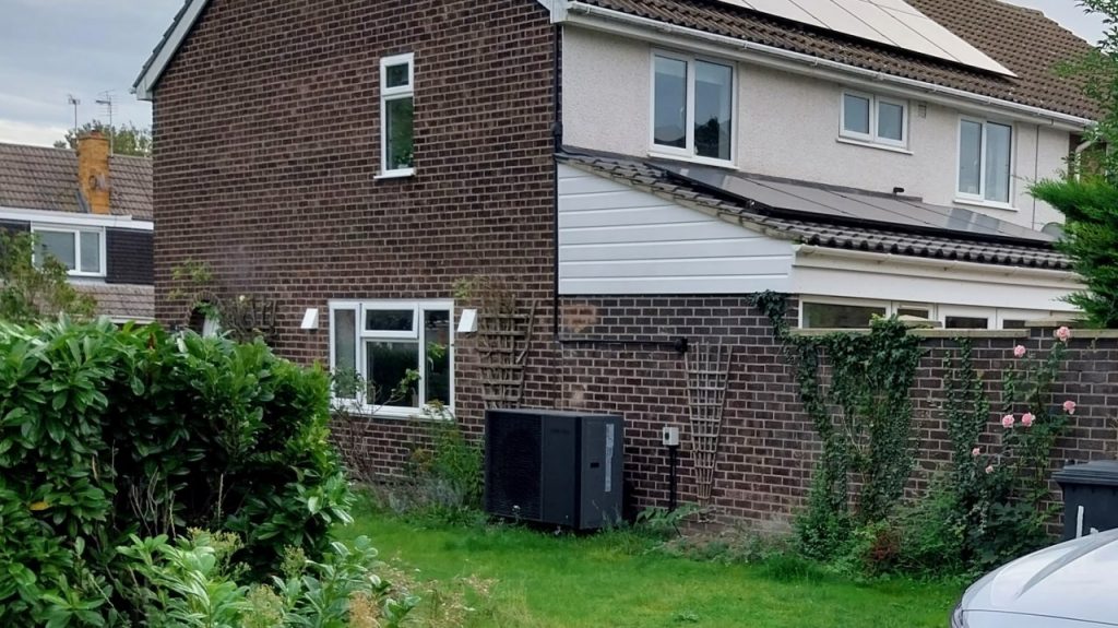

Wife’s Friend: I’ve been mulling over where to place the heat pump, where the tank would go, the costs involved, and if there are any grants available.
Jez: Typically, you’d want the heat pump close to the house to keep installation costs down. It requires a little space around it for air intake and servicing. The water tank should ideally be on the other side of the wall from the heat pump and near hot water outlets to reduce pipework. Costs for installations vary from £8k to £18k, but the government offers a £7.5k grant through the ‘Boiler Upgrade Scheme’ provided you meet certain conditions, like having an up-to-date Energy Performance Certificate (EPC) and no boiler post-installation.

I’d like to hear a bit more about the cost of heat pumps. There is barely any mention of the high cost, only how green and clean they are . Winter running costs are prohibitive for the average family. ( £400 per month in our case for a highly insulated 4 bed new build) . There are also many restrictions on the siting of what are in effect large aircon units.
