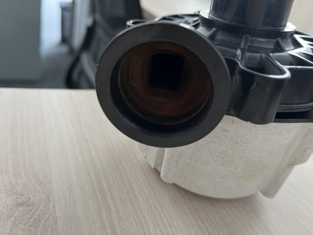

In this article, I want to take highlight the significance of water quality in heat pump systems by sharing some photos of a broken circulation pump. While there are several potential causes of damage, the most common culprit is often the cheapest component of the system: water.

Debris & Contaminants: Without proper filtration, debris can circulate within the system, leading to blockages and damage to the moving parts of the circulation pump, as shown in the images below.
The Impact on Circulation Pumps
The circulation pump is the heart of a heat pump system, responsible for moving water throughout the system. Poor water quality takes a toll on this critical component, often being the first to show signs of damage. The images provided illustrate several key issues:
Impeller Wear: Contaminants in the water can erode or clog the impeller, which is vital for water movement.
Seal Degradation: Poor water quality can degrade the seals within the pump, causing leaks and further mechanical issues.
Internal Corrosion: Corrosion due to improper water chemistry can severely impact the pump’s efficiency and lead to complete system failure.
