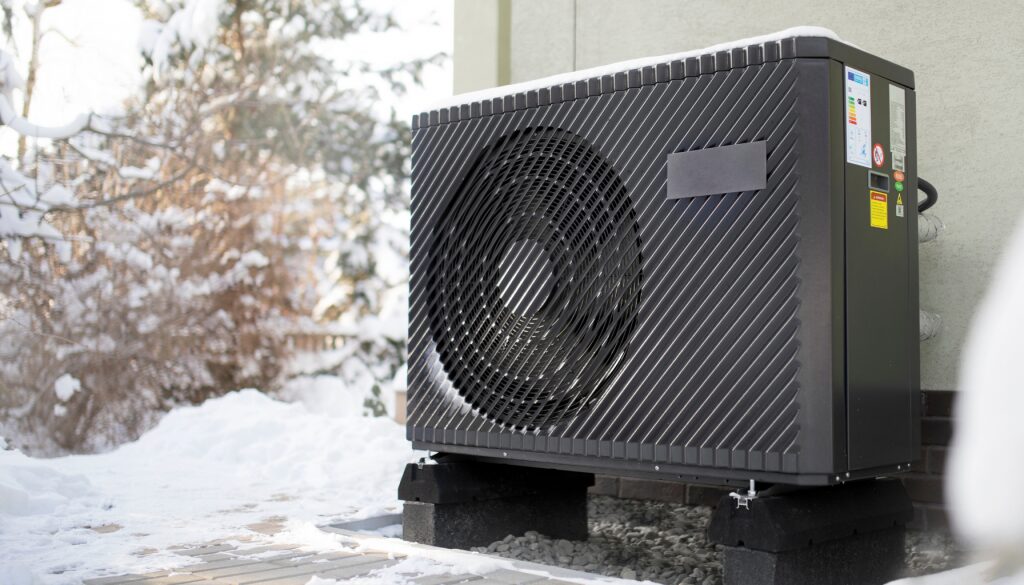

In the world of heat pumps, manufacturers and suppliers often warn us about the risk of units freezing up, which understandably causes a lot of concern. But is this panic really justified?
At its core, a heat pump is just a big box in your garden, connected to your home with water pipes that, if installed correctly, should be well insulated. The concern stems from the fact that water freezes at 0°C, and when water freezes, it expands with enough force to split pipes or damage components within the heat pump. Naturally, no one wants to deal with that.
