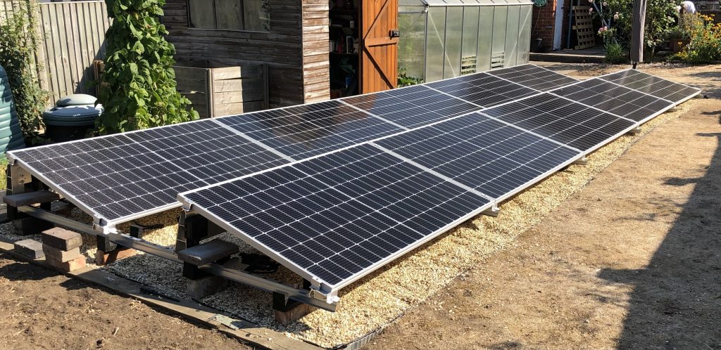

Research showed that producing my own electricity from solar photovoltaic (PV) panels would be a very good start. Placing solar panels on your roof falls under ‘permitted development,’ thus not requiring planning permission. To produce enough energy for day-to-day needs, I used several roof areas and also placed some panels in the garden. Chimneys may cast shadows over some panels during parts of the day, reducing their production at those times.
Not only do I have shading from a chimney, but also from late September, I experience shading from nearby trees until their leaves drop some weeks later, after which the production slightly increases. My PV array has a total rating of 8.1 kWp (peak), which on a good sunny summer day may produce 35-40 kW/h. However, this figure may drop to approximately 4 kW/h in winter due to the low-lying sun and resultant shading, as well as the reduced solar energy. For instance, solar production for September 2023 amounted to 662 kW/h, while the production for December 2022 was 107 kW/h.
solar PV array
Regarding the siting of panels, the ideal orientation is due south. However, the orientation of your house or other buildings may dictate this for you. Panels can face east, south, or west, or points in between; it is best to avoid north. The inclination is dictated by the angle of the roofs, and again, this will be fixed. My own panels are sited in varying orientations, some SSE, others SW, so slightly less than optimum. An array with varying orientations is beneficial as the harvest is spread over more hours as the sun tracks around.
I looked for the most efficient panels and decided that individual micro-inverters on them would provide the most reliable performance. Individual micro-inverters ensure that any shaded panels don’t restrict the output from other panels. There are also ‘string inverters,’ but some of these are affected by shading to a lesser or greater degree.
The micro-inverters are needed to convert the Direct Current (DC) from each panel to Alternating Current (AC), unifying the voltage before sending it to the controlling switchgear, which is situated, along with the battery, in the extension at the side of the house. Some battery systems can be situated outside, while others need to be sheltered from the elements. Either way, I feel that if they are in a dry, frost-free environment away from extremes of heat and cold, they are likely to have a longer active life.
