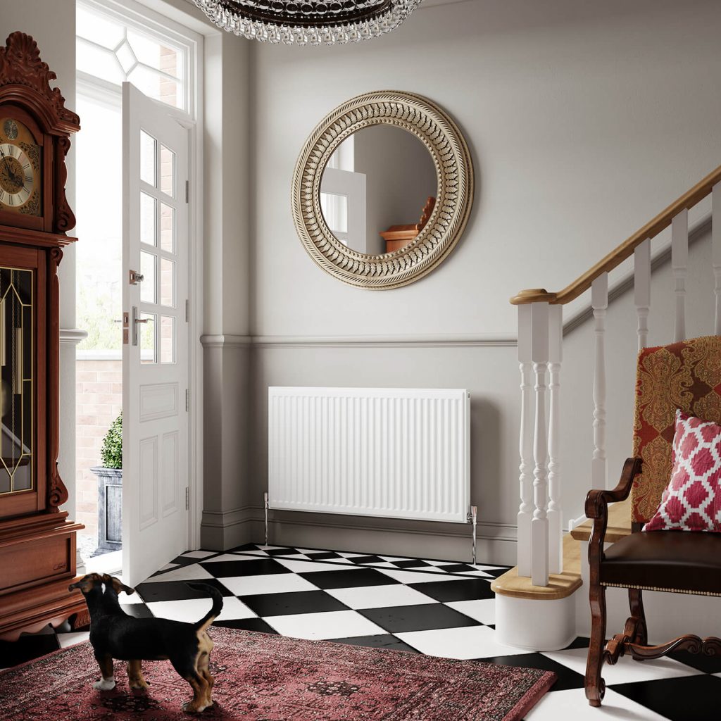

Stelrad 600 x 800
Radiators do not have fixed outputs. The room temperature, as well as the flow and return temperatures, have a bearing on what the heat output will be.
A type 22 compact double convector radiator – 600mm(H) x 800mm(w) – has the following outputs for different scenarios.
