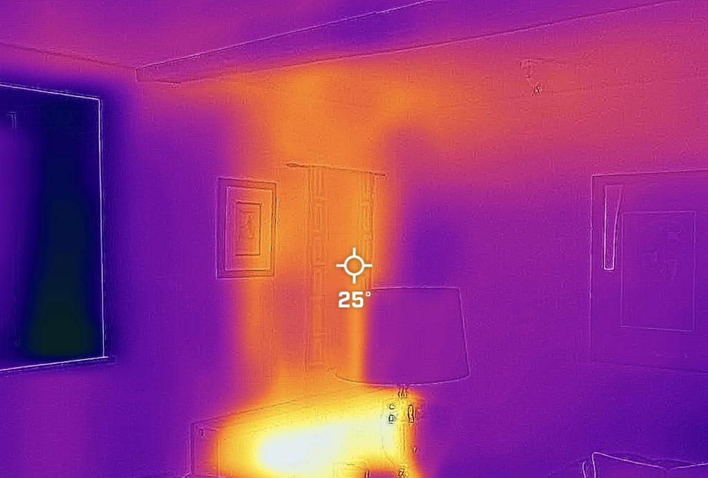

Our TV room, the coldest room in the house, is a great example. When it’s 6-10C outside, with a flow temperature of 45C, when you walk in you can feel the heat. It’s not uncomfortable, but you feel the gentle warmth on your face. The room is cosy, but after spending some time in it it becomes noticeably warm. The target temperature is 21C. At the same target temperature (21C), with weather compensation activated, when you enter the TV room it feels normal – it’s not cold, it’s not warm. It’s down the line. No warmth on your cheeks, and the room is also at 21C. So both achieve the same target temperature, but weather compensation is using between 30-35% less electricity on mild days (above 6C). It’s a massive saving.
What’s clear in the thermal images of the TV room below, is that the radiator is at 30C, with the air rising at 25C and moving across the room to keep it at our target temperature of 21C (the sofa). The ambient temperature was 6C outside and the flow temperature was at 34C.
