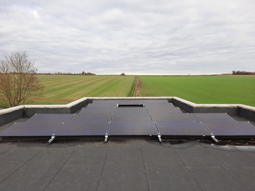

The final specification was for 18 QCell 315W panels with micro inverters, a SolarEdge 3680 HD wave inverter with integrated EV charging, a GivEnergy 3kW AC coupled inverter, two GivEnergy 5.2kWh batteries (which I’ve reviewed here) and a SolarEdge hot water controller.
We decided to mount the PV panels on the smaller flat roof because it was easier to make the necessary structural calculations for reinforced concrete than for the atypical materials used in the new roof. A small perimeter of brickwork completely hides the panels from view, even when someone is walking along the field opposite the house. The pitch of the panels is 10 degrees, so output will be less than 5.6kWp unless the sun is overhead.
