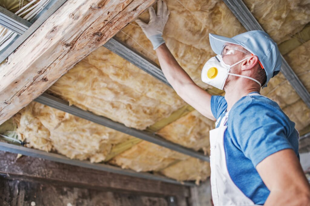

  1. Insulation: no matter how efficient the heat source is, at the end of the day it matters how well your house can retain the heat, so it is our first item to consider. When talking with the installer or contractor, your first question should be what is the insulation “R” value of the house. Usually it’s the “R” value that determines the overall rating. Higher is better. The house energy efficiency (A, A+ or A++) depends on the “R” value of the insulation. If your house is lower than “B” then it’s a better idea to spend your resources in improving the efficiency of the house first.
