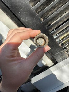

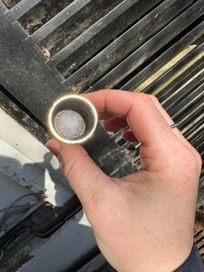

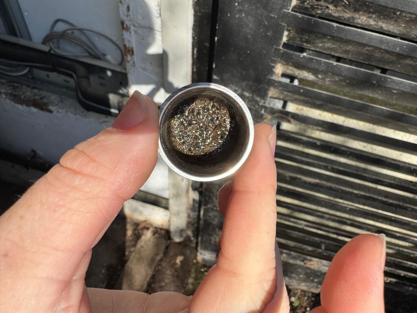

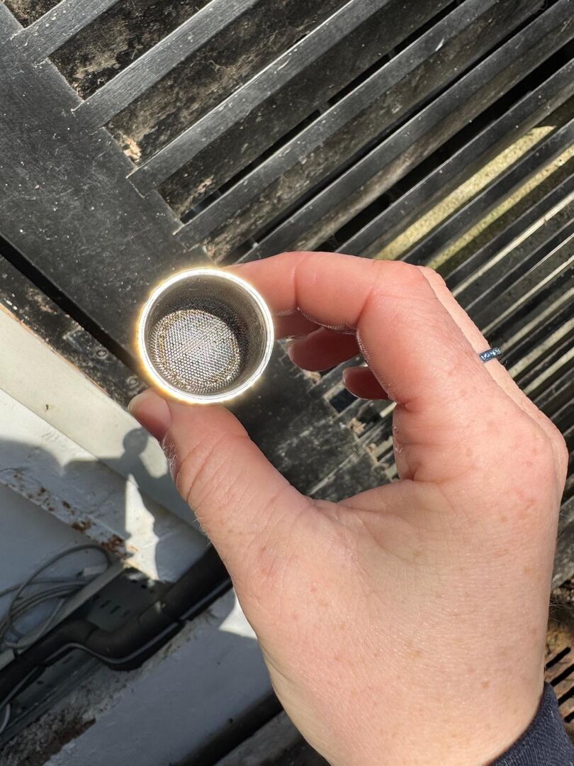

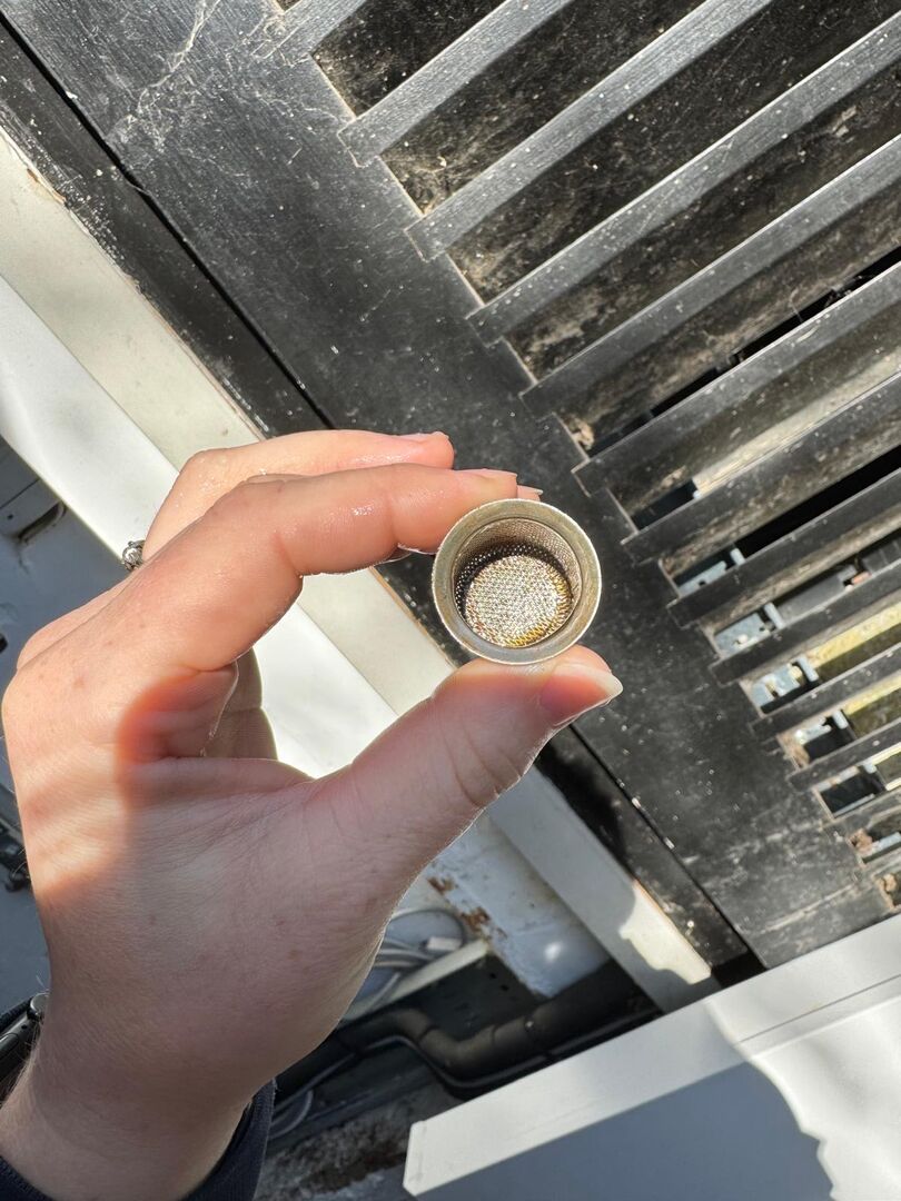

@toodles your account struck a chord with us and it raises some serious questions about what’s being claimed vs what’s being done during heat pump servicing.
You can read the full story here:
If anyone else has had similar experiences (or very different ones) we’d love to hear from you. And if there are any service engineers in the community willing to weigh in on what a proper annual service should involve, please jump in. Your insights could really help inform and protect other homeowners.
