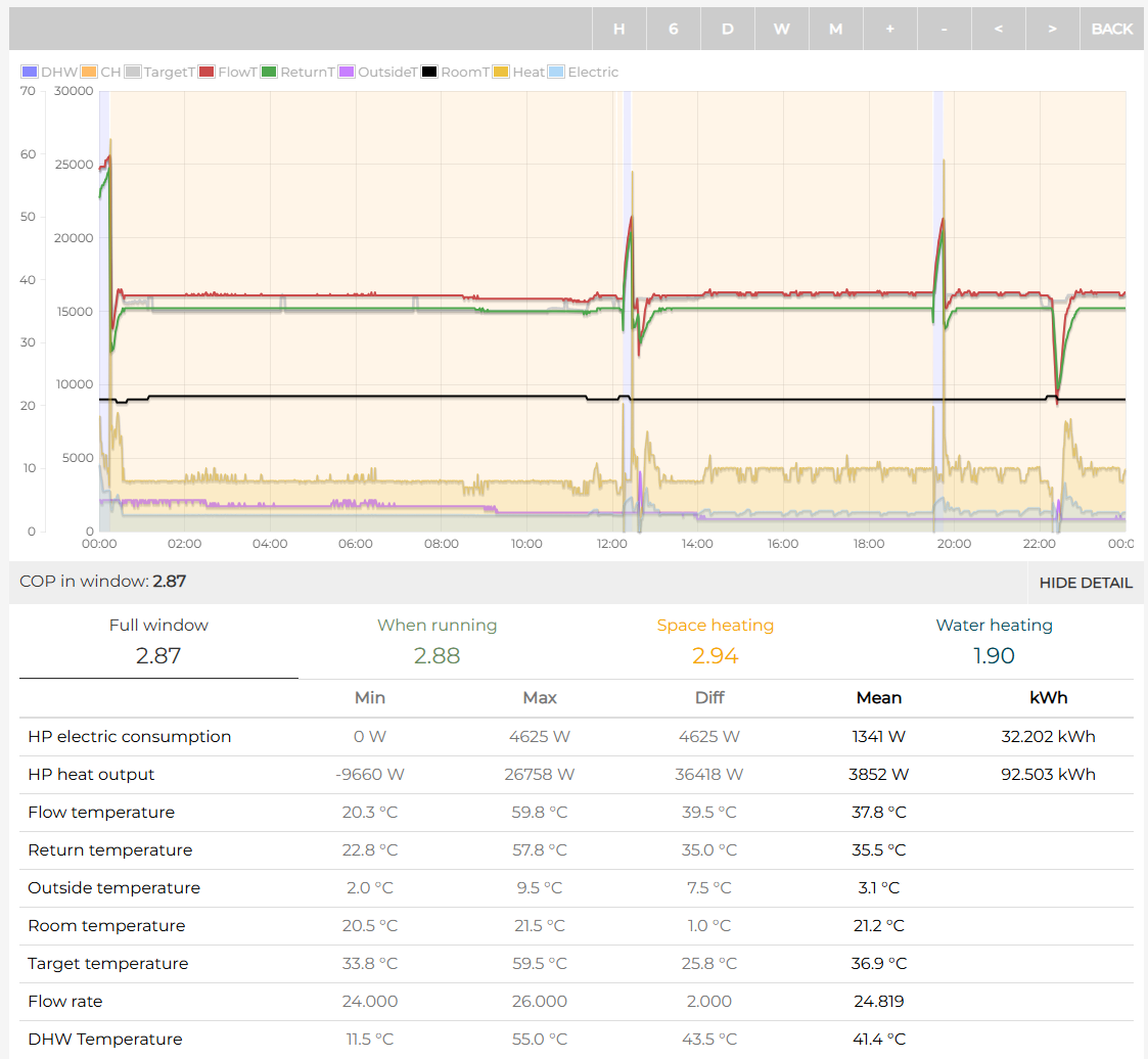

To summarise the type of variance I'm talking about, I've used data from 5th February in the images below.  This day has been the 'cleanest' full day of operation I've seen from the system, with almost 24 hours of equilibrium running being interrupted only by a couple of defrost cycles and 3 short periods of DHW heating.  The summary from emoncms (the Home Assistant integration) for the day is shown below, in simplified form (i.e. without lines for flow rate, DHW temp and instantaneous COP which I normally have showing):
Screenshot 2026 02 09 185627
As can be seen, the profile during heating operation (the yellow background) is about as good as it gets in terms of stable running, and the heating COP of 2.94 at an average outside air temperature of 3.1°C (which is low for many people) would be 'acceptable' from my perspective and would likely indicate a SCOP of 3.3 or 3.4 to be achievable over a full year, which would match my initial expectations of what might be achievable for the system at installation.  I should note at this point that the system is delivering significant cost savings relative to the gas boiler it replaced, currently in the region of 40-50% on the equivalent period last year, so the low COP is something of a 'niggle' for me rather than a fundamental concern about the installation.
The link to the MelPump data for the same day is also linked below.  This is 'interactive' so is easy to interrogate specific data points within it, but essentially provides the same overall picture for the day.  Note in particular that the instantaneous COP figure at pretty much any point of the equilibrium is consistently around or just below the 3.0 mark during the day, and entirely consistent with the emoncms figure of 2.94 as shown above.  The system spent most of the day running at a compressor frequency of 26-30Hz, at an input power of just over 1kW.  The lowest power input I typically see from the system is 940W, so it was operating close to this for a prolonged period of time.  (NB: Ignore the image that displays on the post directly, as this is just a 'stock' image from MelPump.  Click on the hyperlink to open the actual data).
https://melpump.com/public-report/view/019c3265-0f21-7df3-81e6-df7ebbcf8e67
As had become the norm during this period of scrutiny, the Ecodan produced data for that day, which MelPump collates within its daily reporting statistics, showed a Heating COP for that day of 2.62 and an overall COP of 2.56.  The daily COP figure in both cases was 0.32 lower than that represented in the above picture, and there are very few points during the day's profile where the instant COP is as low as that.  The daily totals simply don't match the output, which is a picture I've been seeing consistently in the 16 days of auto-adaptive monitoring so far.

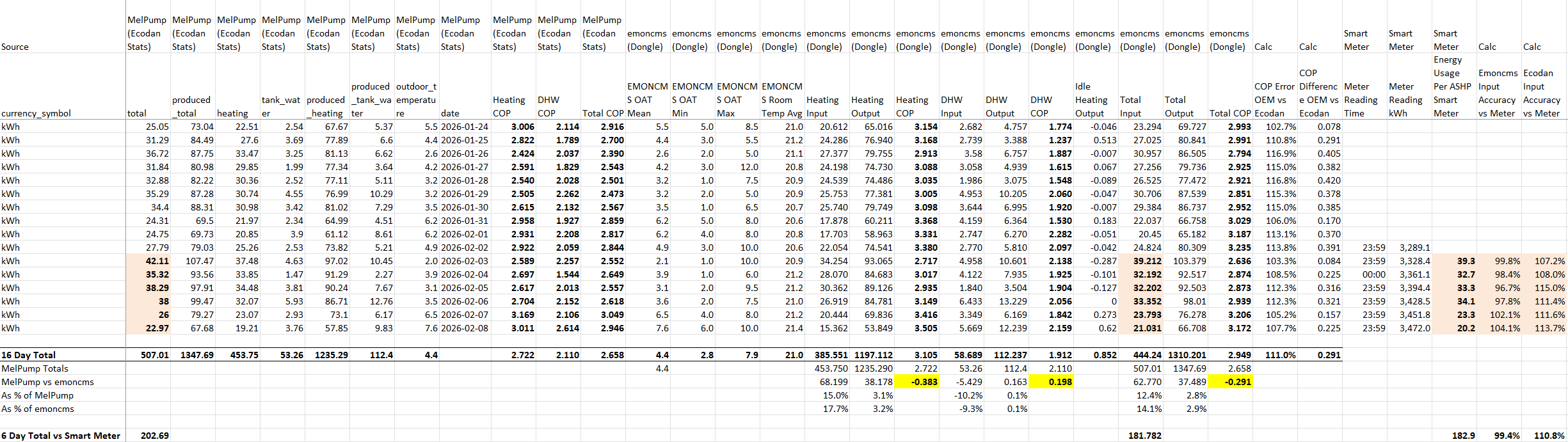

I've attached below a spreadsheet analysis of the daily reported totals over the period in which Auto-Adapt has been the mode of operation for the system.  Over the 16 day period, the Ecodan Heating COP figure has been under-reported by an average of 0.38 each day, with the overall daily COP being under-reported by an average of 0.29 per day.  Typically, some of the heating error is recovered by the DHW reporting, but both the heating and total COP differences are significant.
Screenshot 2026 02 09 184435
Obviously, the immediate point of challenge is to establish which of the two figures looks to be the accurate one (as it's feasible that the emoncms data might be over-reporting performance).  The most significant element of the difference arises from the recorded input power within the reporting.  The salmon shaded cells on the analysis show the reported usage compared to daily meter readings I've been taking from the Smart Meter installed with the ASHP at midnight on each of the last few days.  This shows the the dongle/emoncms figures are 99.4% accurate over 6 days so far, so are under-reporting usage very slightly.  By contrast, the Ecodan data is, on average, being over-stated by an average of 10.8% each day.
I don't have daily smart meter readings to assess the period prior to this, but I can track from the daily calculations the percentage by which the Ecodan reporting differs from the emoncms reporting.  In the 16 days of Auto-Adaptive running, this difference has been 11.0%.  In the 45 days prior to this, when the system has been mostly run on weather compensation, the equivalent difference was only 3.6%.  So whilst there is likely an element of under-reporting performance across all modes of operation, the scale of the error increases significantly when the system runs in auto-adaptive mode.
The problem with this is that, without the benefit of having the dongle attached to the system or being able to see a daily profile of operation that looks noticeably different to the reported data, then the under-reporting is significant enough to change the interpretation of the system's performance for the end-user.  For the 16 day period in question, I'd be extremely concerned about the average COP from the Ecodan data of only 2.72 at average daily temperatures of 4.4°C.  The picture looks somewhat different when the more likely COP figure looks to be closer to 3.10, prior to any scrutiny of the produced energy figures, which is a topic for another occasion.
So in MELPump the instant CoP figure is derived by my formula inside the adapter for instantaneous power consumption and delivery.
Is this what you feed to EmonCMS or do you have additional independent monitoring which you obtained the 2.94 from?
Emoncms uses the instant power consumption and delivery figures within Home Assistant, which are ultimately those produced via your dongle.  On the input side, at the very least, they look to be pretty good estimates, relative to the meter sourced data.
